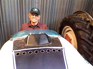

Bob Eastman at home on the Shooting Star.

Note the cut and rivet on the hood to make it fit.

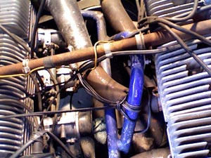

Front motor is partially suspended.
Closeup of the very small carb space on the front engine.
The steering just barely clears the motor.
